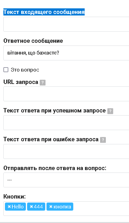

Dyakuyu for vydpovid, but everything is nailed. If I put the Send Viber Alert and edit the button, then the button will be corrected there. Ale, why do we fix something: ? I needed the keyboard to appear immediately, and not less than that, as we take notes and її it’s right.
If I put the Send Viber Alert and edit the button, then the button will be corrected there. Ale, why do we fix something: [file]12800[/file]
you have on the screen a lacquer, which you can tell right away for the day, as it is possible right away after the creation of the process. on your application, you need to add a word and a phrase in the field Text of the incoming message And as a client, write to you in the chat the word, then automatically correct it, as you have added below.
Adding a word - tezh not pracyuє. Bachiv in one of the comments of the retailer, if it’s empty to deprive you, then you can practice at the start. Ale, it doesn’t work like that.
"1. You create an initial setting (greeting) in which you do not specify the text of the incoming message, but indicate the response, for example "Hi. What do you want?" You also create 2 "I want pizza" buttons that will send the text "I want pizza" and "I want a burger", the actions of which are to send the same text. " https://1b.app/ru/forum/other/2825-opishite-pozhaluysta-nastroyki-polzovatelskoy...
https://1b.app/ru/forum/other/2825-opishite-pozhaluysta-nastroyki-polzovatelskoy-klaviaturi-dlya-viber-bot/
well, then you don’t want to work through a business process, only through push? then in order: 1. you created a public viber, published yoga from a smartphone 2. worked out the integration in the box, for example, reviewed the logs in the API 3. adjusted Add setting without completed Text of the incoming message, for example like this 4. sent the client to your public, without writing anything yet, but already saw the first update with the text "ventilation" and buttons like this: screen2 works in me.
then in order:
3. adjusted Add setting without completed Text of the incoming message, for example like this [file]12805[/file]
4. sent the client to your public, without writing anything yet, but already saw the first update with the text "ventilation" and buttons like this: screen2 [file]12806[/file]
works in me.
So right in that everything works good. І buttons are published, notifications come. But if I add a hint, like you have screen 1, then nothing comes up.
ahh, then go to the one that reminds you to come, but without buttons? buttons scatter okremo in distribution +Add button here : screen and program for them size, color, dії And after that, add these buttons at the choice of diї Add setting https://1b.app/en/ajax/download/12805/ wiyshlo?
buttons scatter okremo in distribution +Add button here : screen and program for them size, color, dії [file]12813[/file]
wiyshlo?
