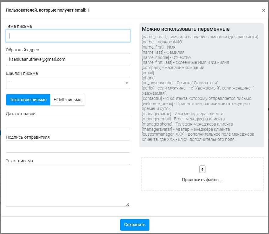

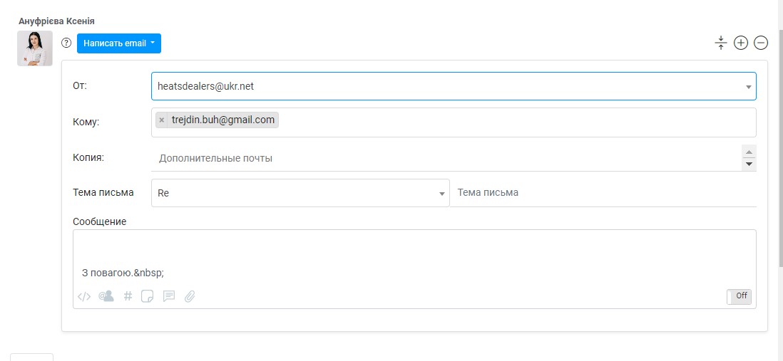

Yesterday, mail really didn't pull up in any of the letter writing forms, although when manually entering the address through the comment bar, the system issued a message about successful sending. Later, an SMTP connection error appeared. I reconnected, and today mail is already pulled up through the comment bar, but SMTP still doesn't work - letters are not sent. I tried different ports and settings, currently only IMAP works. Perhaps the problem is on the ukr.net side - I contacted their technical support.
Questions remain:
In the form for writing a letter through a taboo action, there is no option to select a mail, is this configurable? My active connected mailbox is not set by default, and it is not clear from which connection the letter is being sent (screen 1). This mailbox is not in the list of available accounts in the Mail application - I only see it in the connection settings.
At the same time, in the process, through the comments feed, the email I need is pulled up (screen 2).
Why is the connected mailbox not showing up in the Mail app, but it is in the connections settings? And how do I set it as the default mailbox?
