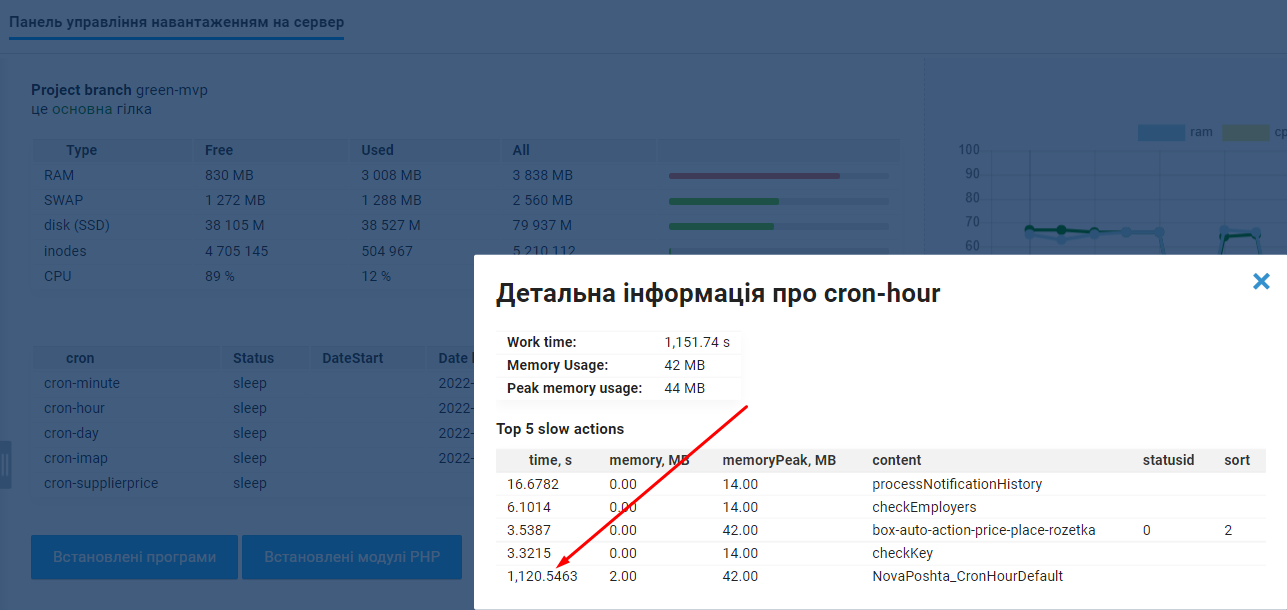

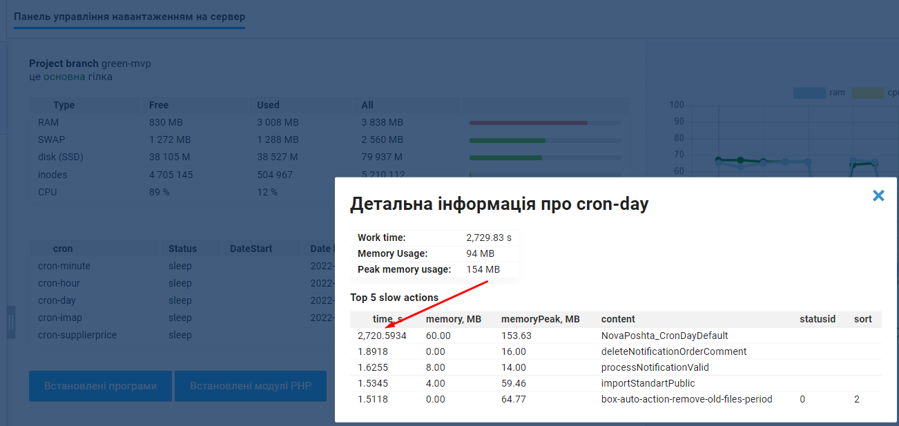

TTN NP are created for a long time in automatic mode
Previously, it took 10-12 seconds to close TTN NP
At the same time, this process takes up a sprat of air, or TTN does not work out in the blink of an eye.
In the care panel, the odd value for the hour for NovaPoshta_CronHourDefault

Similar situation. We only create ttn manually, the new mail tab will not be taken into account (504 Gateway Time-out). In moments for a short hour, it is possible to create ttn.

Olyanitsky Kostyantin Viktorovich, why did you start having problems?
25.01.2022, 16:55
Гуляєв Олександр
Друкарня "Друкарик"
We have reloaded the server. So far, it hasn't dawned on me. Tomorrow we will review.

We also began to lie yesterday. One manager had a 504 Gateway Time-out, another didn't.
This is not similar to the problems of installation, but to the problems of the program itself, or New mail, or it has changed in the rules for the exchange between Box and NP.
Olyanitsky Kostyantin Viktorovich, do you have a powerful server?
We have it.
