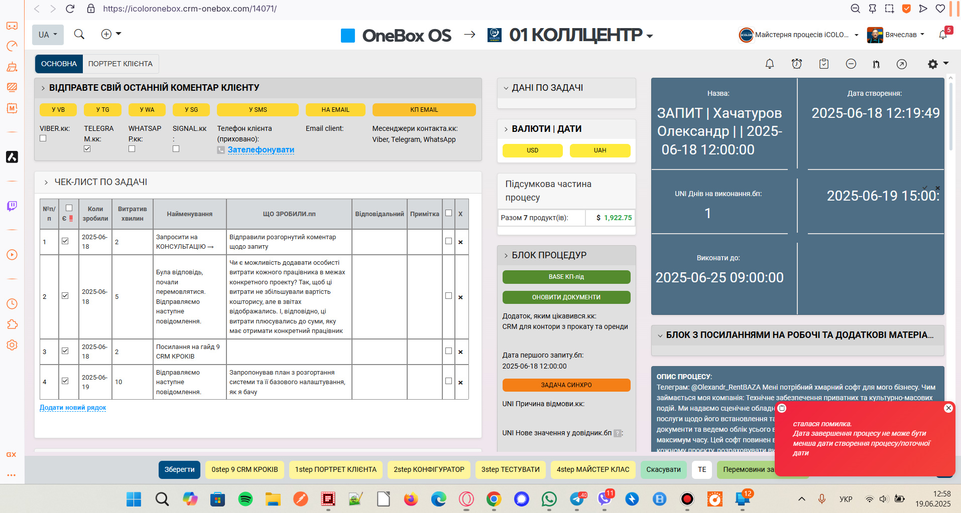

Creation date: 2025-06-18 12:19:49
[file]24092[/file]
Current date: 2025-06-19 12:58
[file]24092[/file]
Set the date Schedule: 2025-06-19 15:00:00
[file]24092[/file]
We try to save, but it gives an error saying that the Process End Date cannot be less than the creation date or the current process date.
[file]24092[/file]
I checked the settings that could affect the date in stages and procedures. I didn't find any that could cause a problem.
[file]24092[/file]
I am attaching a screenshot of the error.
[file]24092[/file]
Looks like a system bug
[file]24092[/file]
Please fix it.
[file]24092[/file]
[file]24092[/file]

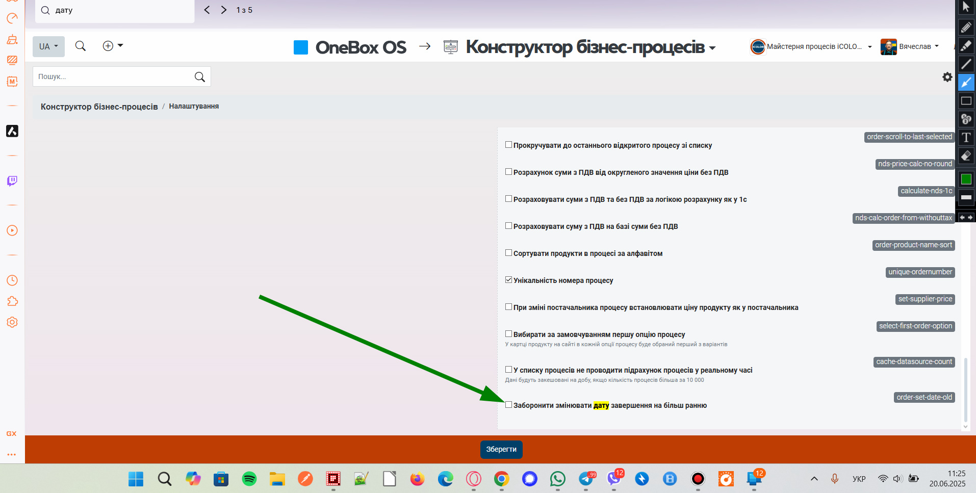

Maksym Vadimovich Tyndyk
OneBox production wrote:
Well, try removing the general setting "Prevent changing the end date to an earlier one" and everything will work out for you.
Thank you very much.
Now it's clear that this checkmark affects the Schedule date, which is not at all obvious from the caption, unfortunately.
In my personal opinion, the completion date is more about the system's Do By date than the Schedule date.
